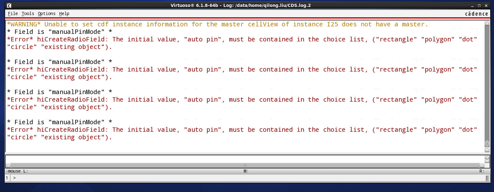

hicreateRadioField"circle:The initial value, "auto pin", 报错解决 ...
已有 1140 次阅读| 2024-4-23 16:58 |系统分类:芯片设计
"**Error* hicreateRadioField"circle:The initial value, "auto pin", must be contained in the choice list, ("rectangle" " polygon " "dot"" "existing object")
解决办法是在.cdsenv里面将auto pin改成("rectangle" " polygon " "dot"" "existing object")中的一个就可以了,语句是pinShape   cyclic    “auto pin”========pinShape   cyclic    “polygon”。
